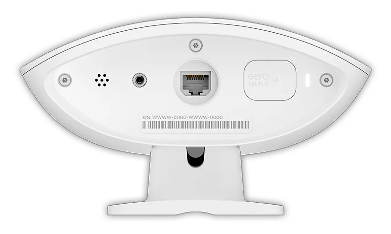

Examining the eero Outdoor 7 Hardware
All of the major I/O (input/output) ports and functions for the eero Outdoor 7 are located on the underside of the unit. The names and primary functions of each I/O port on the eero Outdoor 7 are listed below, in order from left to right:
  1. Watertight Vent: Allows the eero to vent excess heat without exposing the unit to dust, dirt, water, or other contaminants.
  2. Grounding Port: Allows a #8 stranded copper conductor to be attached to the unit, mitigating the effects of a lightning-induced power surge.
  3. 2.5 GbE PoE+ port: Provides connection to the network and power in wired configuration or only power in wireless configuration.
  4. Reset Button: Enables manual soft and hard reset of eero hardware as needed for troubleshooting.
  5. Status LED: Provides up-to-date information on the current status of the eero unit. See What do the colors of the LED light on my eero mean?
