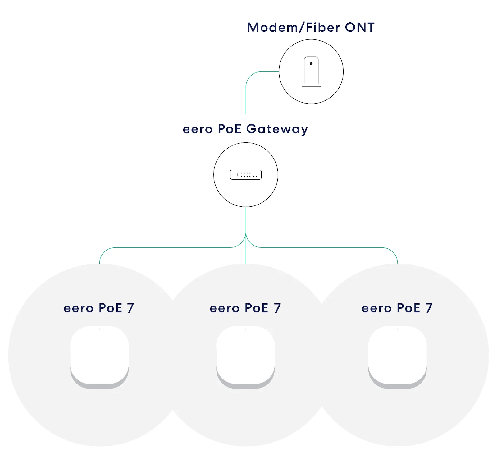

Network layout: You'll need a gateway eero between your modem and your PoE switch. The gateway eero manages your internet connection and routes traffic to your other eeros. If you are using an eero PoE 7 as a gateway, it will require an additional power source: PoE+ 25.5W (802.3at) or 27W USB-C power adapter (sold separately).
Connection port: Connect your PoE cable to the left-hand Ethernet port marked "10" on your eero PoE 7. This port handles both your internet connection and power input.
Professional installation recommended: Setting up PoE networks can be complex. We recommend working with a professional installer to ensure everything's configured correctly. See below for our recommended topology setup:

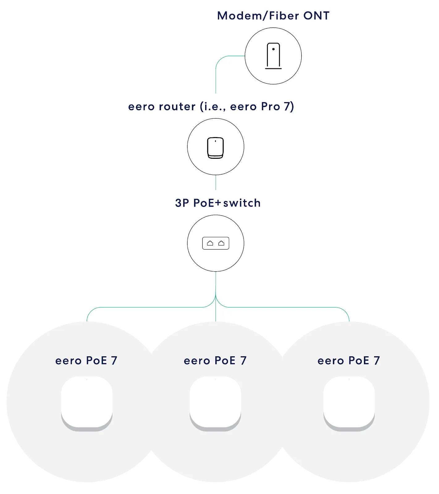

If you decide to use a third-party PoE+ switch or injector, keep in mind when setting up your network that the gateway eero must be placed ”in front” (upstream) of the PoE+ switch, between the modem/ONT and the PoE+ switch. See below:

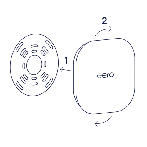

Step 5: Attach the device
  1. Place your eero PoE 7 onto the mounting bracket
  2. Turn the device clockwise until you hear a click
  3. Keep turning until you hear a snap—it's now securely in place
